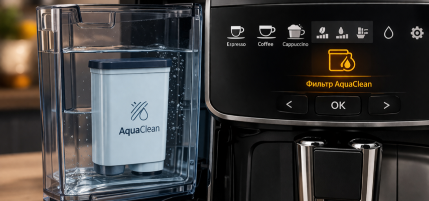

Bak_Philips_s_ustanovlennym_filtrom_AquaClean_ryadom__goryashii_indikator_filtra_na_paneli.thumb.png.dfd3d014b3dd947f79e6fffc8264434c.png

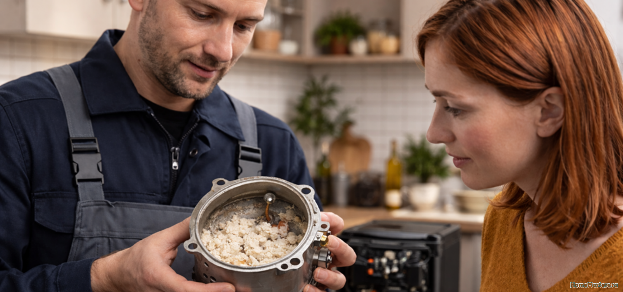

Master_pokazyvaet_klientu_staryi_boiler_napolovinu_zapolnennyi_kamennoi_(izvestkovoi)_nakipyu.thumb.png.001b6f184347a91cc234585110e7927f.png

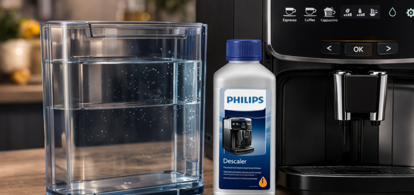

Bak_s_vodoi_i_flakon_firmennogo_sredstva_dlya_udaleniya_nakipi_ryadom_kofemashina.thumb.png.429a655e7509ff30c3a0a67e3fa922ab.png
